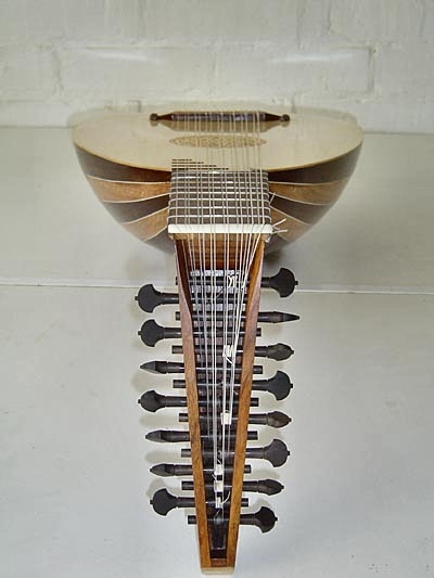

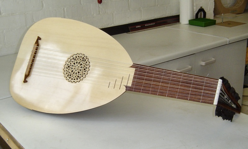

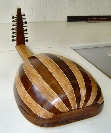

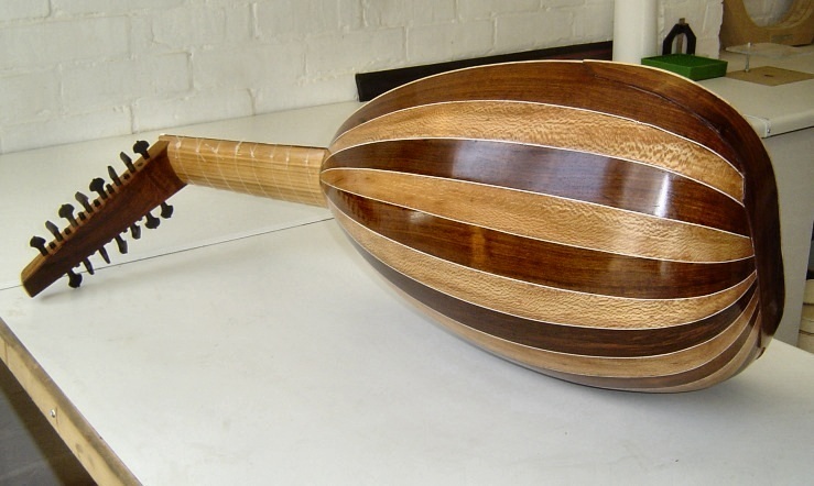

My latest, an 8-course lute after a mid 16th century lute by Giovanni Heiber is finally finished.
The Shell is 13 staves of EIR and London Plane, neck is European Cherry with an EIR veneer, EIR pegbox with ebony pegs.
The top is Swiss spruce with a rosewood and cherry bridge. The top is not a true book match but does come from the same billet of very old (preWW1) spruce, their partners seem to have been misplaced before I got the wood. It is one of the stiffest tops I've ever found and eventually ended up with a thickness of about 0.075" in the centre tapering to 0.065" at the lower bass.
I thought you might like to see the bracing, standard ladders with one large and two small 'tone' bars behind the bridge. The braces are relatively narrow and tall, most at 3mm x 9mm and the two main braces 4mm x 18mm. I'm going narrower and taller on my guitars in future.
I built this one to sit next to my chair at home so that I can pick it up for a quick twiddle whenever the mood takes me. I'm please with the final sound, which seems to be clean and balanced with that 'silvery' Renaissance lute tone.

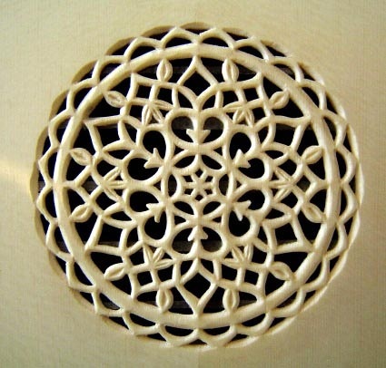

What can I say - you are one of the few really worthy of the title "luthier". That is majestic. The rosette alone is a masterpiece but when it's put with the whole instrument it is inspired.

A qouple of questions if you don't mind: I notice a couple of the upper (gut?) frets are tied on somewhat angeled. Is this customary, for some special tuning, or something you would adjust before playing? A couple of years ago a German lute was brought to me for repair (which I turned down), and I remember the soundboard was unfinished. The owner told me lute tops usually were like this, but your top looks finished; is it?

That rosette is wonderful.

Wow...I DIG that soundhole carving thingamajiggy-whatchacallit!

Arnt, no I had just put the frets on and hadn't accurately positioned them, but yes you do have to check them everytime you take it out of the case. I use my wife's ears to tell me when they are wrongly positioned. Many of the Germanic lute makers didn't finish their tops, I once repaired a Brunner archlute that had never been finished on the top but they tended to use thicker tops than the Italians, Italian lutes had a finish on them, I just used a very thin coat of French Polish on this one.

Colin, please indulge a quick question I have. What is a good length and width to cut lute ribs? I've been saving back a nice piece of quartered Yew with an extra wide sap band for lute ribs. I've not had much luck locating a good "average" size to cut. Any thoughts to share? I always cut to produce the most options.

Larry, For a standard sized tenor Renaissance lute 60cm x 5 cm (24"x 2") should get you there, with a bit to spare, for 13 stave shells. For more staves, you can of coarse go a little narrower but the above will give the builder an option. An Archlute of Theobro would need longer staves. The largest staves on this one are the two top ones that are at their biggest 57cm x 4.5cm. Finished thickness is about 2-2.5mm
I've used English Yew (Taxus baccata) on two lutes it is a fantastic wood for the staves. I've still got half the tree in bits at the bottom of my garden, it blew over in a storm in 1987. It was an ancient tree when my house was built and that was 600 years ago!
